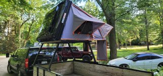

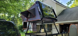

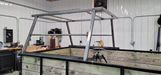

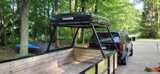

Well, I got the trailer set up this weekend. I fabbed up this apparatus that bolts to the trailer and holds the tent. Zero blockage of the rearview mirror and plenty of storage under the tent. Using the trailer for the tent is nice because I can disconnect the vehicle and leave camp set-up. And the trailer will house everything else I bring (gear, grill, firewood, fuel, generator, etc...) I also welded on corner jacks to stabilize the trailer. Looking forward to it's maiden voyage in a couple weeks!
I'm still waiting for my Rhino Rack to come in. But it will be nice to have the option to use the tend on the trailer or the Suburban.

Thanks! Yeah, built it myself. I'm an "extreme DIY" kind of guy, so if I own it and it's made of steel, there's a 50% chance it's homemade. :)

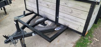

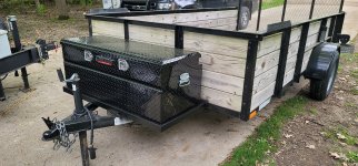

And when I bought the trailer a month ago, I put new wheels/tires on it and kept an old one for a spare. So I framed up an area up front, and mounted the spare and also a tongue box.
