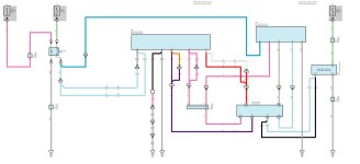

Center blue box is the heater assembly. Lower blue box is the amplifier.
There's a temp sensor in the heater that tells the amplifier if the seats too hot.
What's needed is a scan tool to read the temp.
I can see if I can find some voltages to test but right off it looks like I need a scan tool. I also need to grab the connector diagram to show what's on what.
One easy test is, when it shuts off see if the relay is still powering the light blue wire. If thats shutting off, the relay needs replacing. If its not that, now your digging in a bit.
